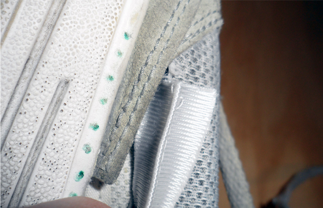

1. Mark dots with a pen where you will drill holes along the length of the sole spaced about 5 mm apart along the length of the tear. I tend to make the hole spacing a little tighter near the clipper stall area in order to provide more support for the fabric.
2. Secure the shoe in a vise with the instep facing upwards. I usually put some shop towel or foam (not shown in picture) between the shoe and the vise to help prevent gripping damage.
3. Put on safety glasses and use a power drill with 1/16” drill bit to predrill the holes along the uppermost part of the sole. I do not recommend putting your hand into the shoe while drilling as there is a danger that you may drill a finger. If you feel like you need additional support to prevent the sole from flexing while drilling, handi-clamps supporting the sole on each side of the hole are a good solution.

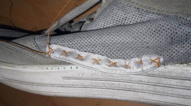

6. Find a piece of synthetic bias tape that is stronger and more durable than the instep fabric and cut it to the length of the tear. I didn’t have any bias tape, so I used some trim from an old pair of basketball shorts
7. Fold the bias tape around the edge of the instep fabric and pin in place with bobby pins or sewing pins
8. Sew the bias tape to the instep fabric using the denim thread and a needle. Use diagonal stitches going from the direction of the heel to the toe
Then come back again from toe to the heel with diagonal stitches orientated such that you end up with little crosses or x’s along the length of the bias tape.
Make sure to smooth out the bias tape as you go to prevent material bunching. Also make sure the instep fabric is pushed in far enough to the bias tape to catch both the upper and lower stitches. I have included an additional image from the inside of the shoe for your reference:
